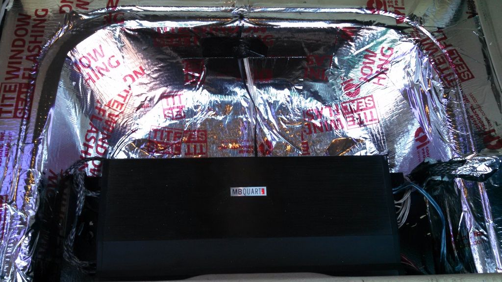

    I will throw this in as well.
    Cheap sound deadening. Less the $20 for 33² ft. It is only 5mils thick but 3 rolls is enough to cover the entire inside of a wagon and then some. I did double it up on the front doors and front floorboards. Then tripled it behind my sub box.
    Works enough that driving down the interstate I used to have the volume up between 19-22. Now it is more in the 15-17 range. Using a free sound level app long before I did any deadening the levels were high 70 to low 80. That was just road noise. No music. Now high 60 to low 70. Wind noise is my biggest issue now. Old seals.
    My mb quart amp BTW.
    On a side note my bass sounds deeper now with all the deadening installed. I also installed 1/8" thick foam tape along all the interior panels. So there is hardly any rattles inside the car. Even on the outside there are a few places I need to address yet but they are not real bad.

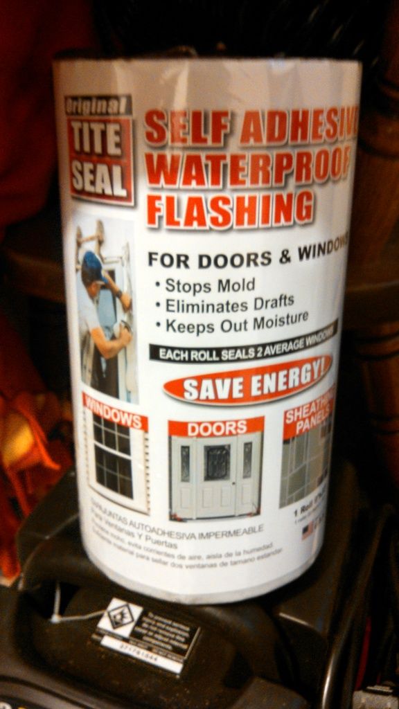

    @toka100 what is that deadening mat and where can someone procure it? nm I found it.....

    Shit I forgot to post that.
    I got this from Menard's. I'm sure any home improvement place has something similar. Menard's also had narrow strips for tight areas like the rear hatch.
    Use short sections if you install by yourself. If it sticks to itself its near impossible to get it unstuck. Which is a good thing. I also havnt noticed any odor from it either.

    Still wise to check if it's asphalt based

    It probably is. Pretty much all that type of flashing is. That's why dynamat costs what it does.

    yeah, asphalt based - http://www.cofair.com/window.aspx

    Bad juju in a hot car in the summer sun. After a time it would prob stop though. No idea how long it would take.

    glad I found that out before pulling the trigger.
